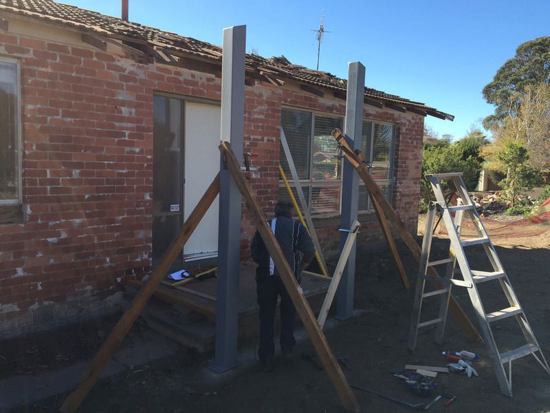

So on the weekends I have been doing more pre sheeting work which takes a lot of time for not much reward. Some more grinding of the render and I have also been busy digging a few trenches for the tradies toilet plumbing. This weekend we only had 1 day at the house due to the wife’s bday. On saturday we put up the framework for the new front porch.

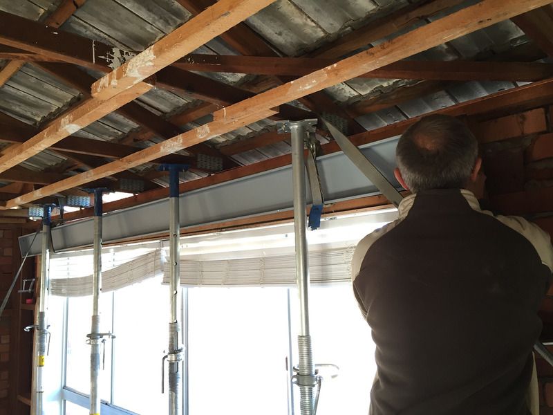

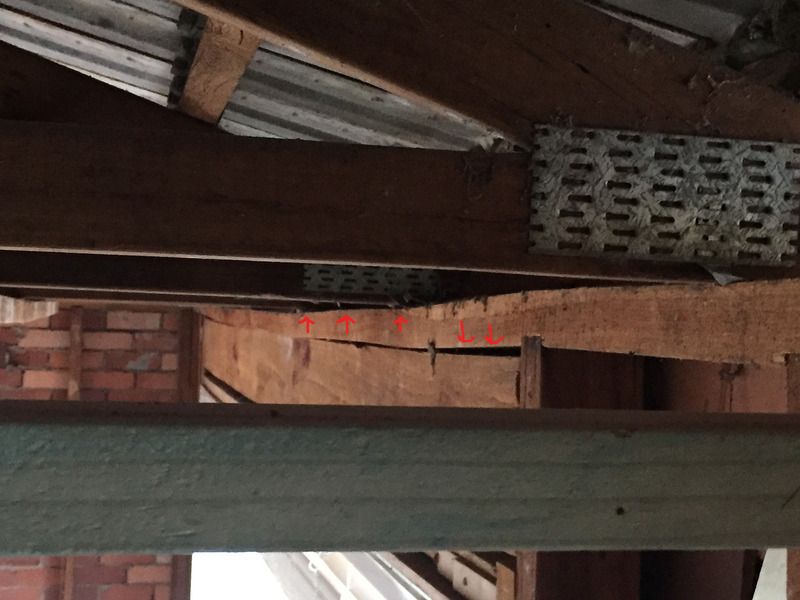

The big thing that was worked on last weekend was removing a 3.8m timber lintel and replacing it with a steel version. Because the lintel was timber, over time it had shrunk. This caused the roof to develop a dip in it as the trusses sit on this bit of timber. We now have a dipless roof. The huge bit of timber that came out will be recycled and turned into our new dining table top, there are also a few other lintels that I will also recycle and make furniture out of.

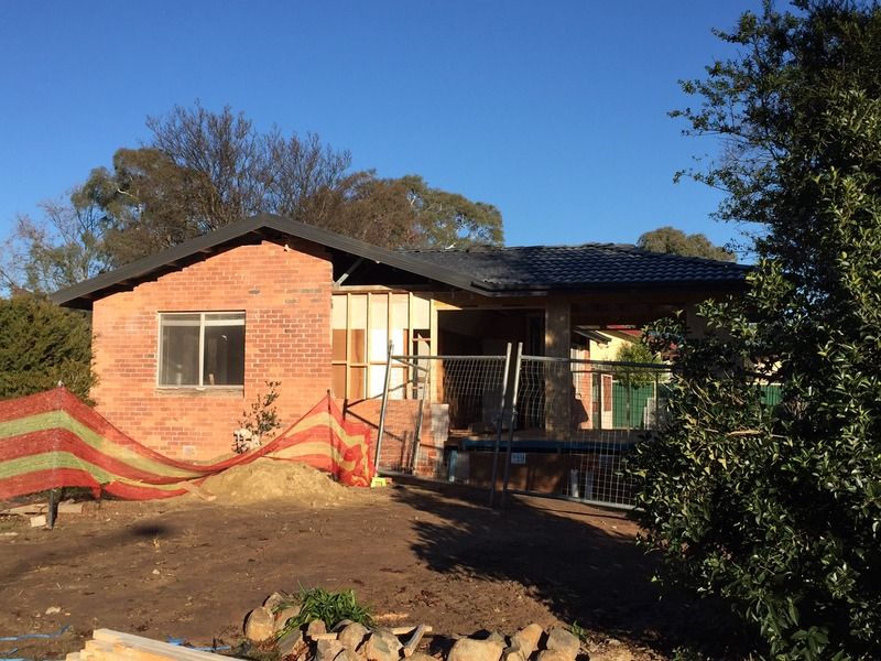

On Monday we had the roof tilers on site to put down the sarking, new battens and the tiles on the extension. It’s now that the house is starting to reveal itself! It was really exciting to see.
Monday afternoon Ivan spotted something… the end of the house had a bit of a rise, he got the tape measure out and one of the trusses was the incorrect size. It was too late to have another one made up as the roof tilers would be on site first thing today and it would cost more money to send them home… so we fixed it under iPhone light. It was so cold!

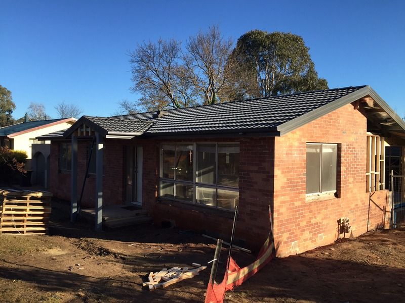

Nude roof. Ivan has taken time off work to get things moving along… we insisted he actually head overseas or just stay home and put his feet up for a few weeks, but Ivan loves to work.
Small update - roof complete.
