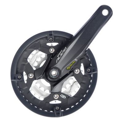

At $14 new, I think this may be a good deal:
Any issues with Octalink? Is it totally obsolete? Only issue I can think of is that I’ll have to have it fitted by the LBS… less of a bargain then eh.
In my uneducated opinion, I’ve not had any issues with Octalink BB’s/cranks on the bikes I’ve had. Yes, it is somewhat “obsolete” in that it’s an old standard (so is square taper by that definition…)but I wouldn’t count it out based on that. I mean you can still buy spares for them for the time being…
Have the BB and crank fitted by the LBS? Buy/borrow/steal the BB tool and DIY it, if I’ve done it then it can’t be too hard.
