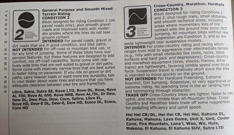

I agree with touring, and road, but not mountain. Did you mean gravel? Gravel bikes are Condition 2, not Condition 3. The marketing departments that want us to believe they can do a bit of everything, and engineering departments clearly disagree.
I rode some of the Stromlo MTB trails on my gravel bike on the weekend. Was fun.
No doubt that underbiking is fun. Depends on the class of track though. I ride my rigid XC bikes - probably better termed ATBs, or flat bar gravel bikes - at the local MTB park. But I don’t knowingly ride them on any black trails or above. There are some trails local to my work where I wonder how anyone can even ride them without a trip to hospital. Almost vertical drops of 2m high, big gap jumps etc. Suffice to say I try to always ride up the new trails in case I make a classification mistake. With a more weight forward, faster steered, thinner tyred bike, one would think the singletrack would have to be chosen carefully, for average riders anyway.
