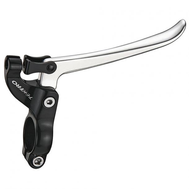

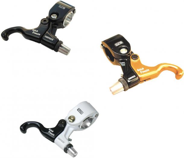

I’m thinking of instead getting some MTB/flat-bar levers and placing them out closer to the ends and was wondering if anybody can give me some pros and cons about my two shortlisted options.
Finger levers
or Flat-bar levers
I ride fixed and have been using the bike brakeless for while and am getting quite comfortable with it but would prefer to keep brakes on for emergencies and lazy days so unless there are some major problems to consider I will most likely bring it down to a decision on aesthetics.

Finger levers: wiggle.com.au | Dia-Compe Tech 99 Gold Finger Brake Levers | Brake Levers
Flat-bar lever: wiggle.com.au | Tektro FL750 Flat Bar Brake Levers | Brake Levers

I wouldn’t bother with the gold-fingers. Had one on one of my bikes and they are no good for regular use of the brakes. You don’t get heaps of leverage from one finger… unless it’s the size of a bratwurst.

You want road levers, non aero cable the best, but aero work.
They should be close to saddle height, too much drop is a bad thing. Also, level the bend, not the flats, they should point down a bit.

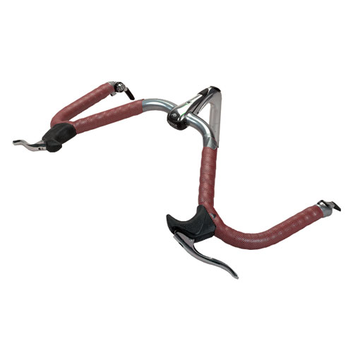

Why not inverse levers? Then you are handling and braking from the back and cranking from the curves.
Dia Compe Inverse Brake Levers, 23.8mm - Levers - Brakes & Parts - Components
^^ I have a set you can buy. Same as above.
If your mostly holding near the ends, might be a better option so you’re not reaching too far forward to brake

What the others said, porteur/city bars with inverse levers are the best solution for you. If you want to keep 'em, get inverse levers designed for 23.8mm bars and have at it.
Might look into the inverse levers though I am leaning towards the finger levers due to their unobtrusiveness and the fact that I am riding mostly brakeless these days. I’m not a commuter cyclist by any means, just use my bike for quick trips down the beach and to the pub on weekends.
This is the current set up on my grocery getter/pub bike. These are the Soma Moustache II bars that have a 22.0mm grip diameter which is why those Shimano levers fit. May not work if your bars use larger diameter tubing.
