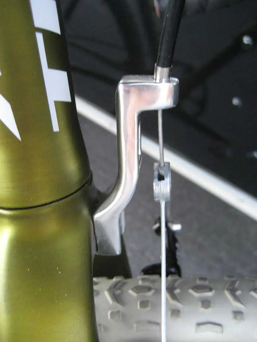

Is there a cable hanger that clamps onto the quill part of the stem instead of being a washer in a 1" threaded headset?
These, but at $50 bit of a rip, what about a fork crown one?
Paul Component Engineering - Funky Monkey Front
Fork isn’t drilled, so headset it is.
I do like the look of that Paul one. Does anyone make a similar (and cheaper) one?
Plenty of stems had inbuilt cable stops (Tioga/Salsa/generic alloy/etc) either through the stem or under the stem.
People used to put hangers under one of the bolts on a 4 bolt faceplate on a threadless stem.
Depending on the clamp style of the stem, you could fabricate something that will hang from the front/backside of the clamp and replace a washer / hang on the clamp bolt / etc.
Or get a cable stop that clamps onto the 22.2mm vertical part of your stem.
Or use a fork crown hanger if the crown is drilled

You had to put the hanger on the booster as the fork crown / headset / stem would move relative to the brake posts / fork lowers / axle on suspension forks, and suspension movement would tighten/slacken the brake cable.
Following the movement to V brakes, cable stops were no longer required, so they were needed for a pretty short period of time.

The stem is a Salsa quill stem.
I like the idea of the Paul clamp. It’s neat and nice. I could drill, but would rather not.
Who makes the hanger that goes through the stem bolt? The one on the bike with the Ritchey bars and Deda stem.
I can it?
EDIT: All of those are way more than the Paul hanger.
It’s a rear cable hanger that goes between the seatclamp bolt. Surly also make a longer, wire version.
Blakey, I found one those stem bolt hangers here.
Yeah, that’s the one I meant. Surlymake a different one and IRDmake a similar one to the one you linked to.
Nah, it was this one that I linked.
No, those are rubbish.
I heard that this one will never give you up OR desert you.
Drill the stem.
+1, Drill the nicest stem you have.
Or buy a VO hanger like the one I just bought?
If it came in black, I would.
Yeah, that $5.50 shimplus any easy to find alloy steerer hanger is flat out the cheapest way to do it. Almost as easy as buying a TCX.
Stop taking the piss! Black hangers are easier to find than silver. PRO, Origin8, Tektro, Problem Solvers, IRD…
