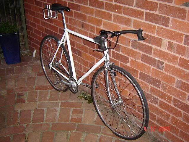

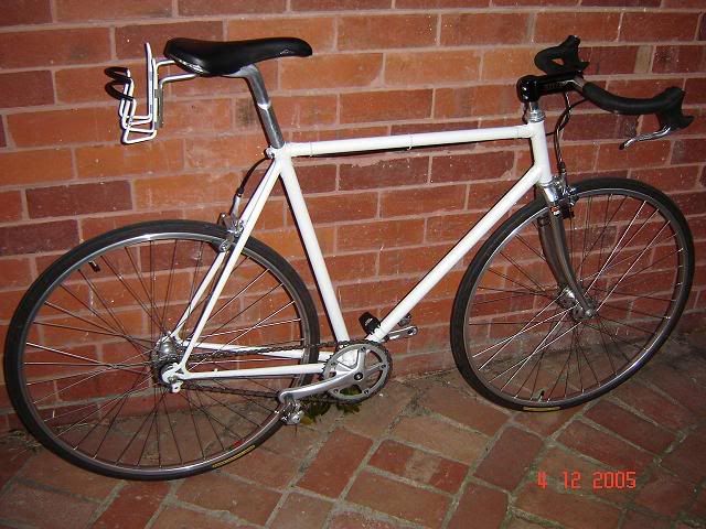

First fixed commuter, circa late '05.
Started out as a dirty old Hillman roadie from mid 70’s scored complete on ebay for fifty bucks. Gordon Hill was kind enough to look through the build cards for me to identify it - the lugs were nailed which I thought was kind of cool
Everything on this build was a bodge of some sort:
Frame: brake bridge re-drilled and frame powdercoated by GripSport (not actually by him, I found out later).
Fork: from a bin at the back of bicycle recycle, steerer thread was farked and needed recutting. didn’t have a quill stem so used quill adapter and ahead stem off an old MTB.
Bars: $10 bargain bin drops, flipped and chopped (mounting the aero brake levers was a hard afternoon’s work…bar had to be drilled on an angle just-so and cable run internally to get the cable run to work…NEVER doing that again).
Crankset: some $10 shitter thing off ebay, chainrings needed (home-made) spacers for chainline
Wheels: off the original roadie. Suicide hub…of course, with an old bottom bracket lock ring thrown on for good measure, QR axle tossed & replaced with fixed axle scrounged from somewhere or other.
TIME layback seatpost cost more than the rest of the bike
and the minoura under-seat bottle mount arrangement lasted less than a week. Was literally a pain in the arse.
After all that, the frame was ultimately too small and the ancient 531 a bit noodly for my liking. But it was a ton o’ fun and the learning was invaluable (mostly learning what things to avoid EVER doing again again). But there was only Dan Hale and about half a dozen regulars on fixed.org for consultaion…and NO production fixxays around to copy off. I posted it on that old geezers’s fixie forum in the US (can’t remember what it was called) and got complimentary emails and requests for build advice for years after.
