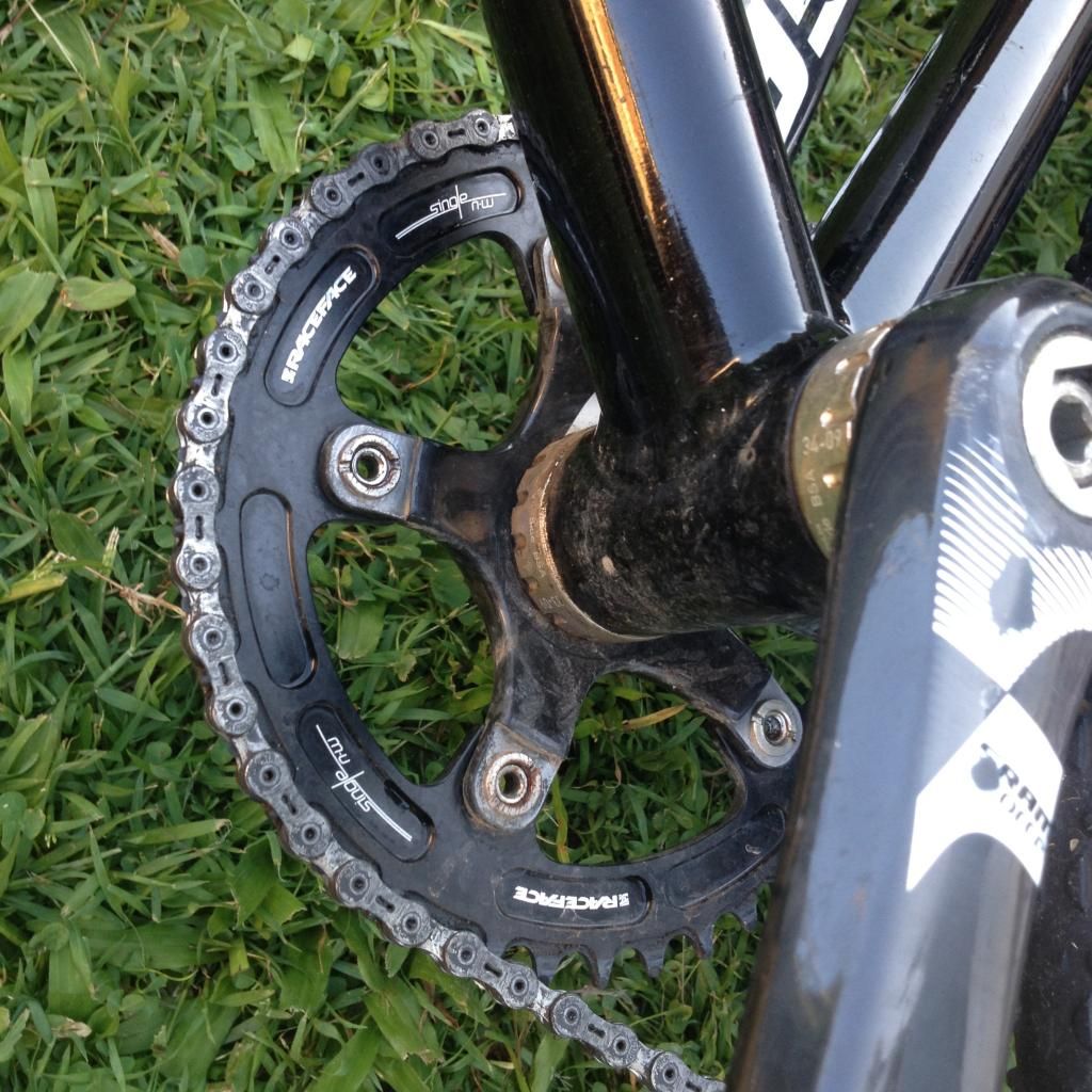

I’ve for a race face ring and FWIW maybe you fide the reverse side so ugly?? At a glance it looks symmetrical but you might wanna check.
Wow great English! Typing on phone walking to bottle’O. And before anyone jumps in I took this flick just now before it got a good bath
Checked. Nothing 130bcd
Yeah I thing I might get one of the and flip it. Cheaper than the wolf tooth ones. Just wich they came in silver/metal

Gonna order me a race face .

And if you hate the RF graphics, just turn the chainring around. 130BCD and 110BCD available. Do it.
