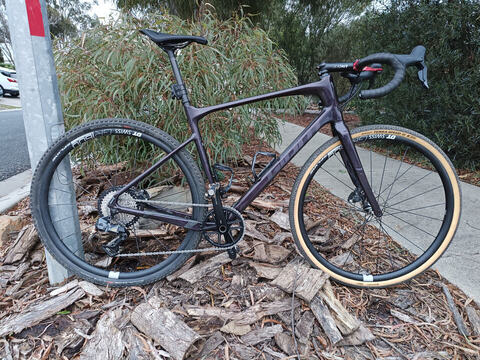

The Ltwoo eGR and new cranks and cassette is on and ready.
Had a bit of trouble getting the app to go and getting the shifter to connect to the derailleur. You need to adjust each gear individually. Sounds like a pain but easy to do and a good feature imo.
Easy to bleed and the rubber hoods are much better than any Shimano hoods I have had.
Very happy so far but only been up and down the street thus far. Hopefully a ride tomorrow if the weather doesn’t turn to poo.
I have a 50mm tyre on the way, to go on the front. Should be better than the 40 on currently and will match the 45 on the back better. Plenty of tyre for most of the terrain I ride.
Yeah, that’s an upgrade for gravel IMO. I think in 10 years people will be wondering how we thought 40 was a good idea for gravel. Kinda like some are with 23s on road now.

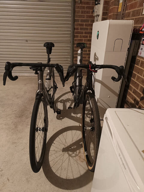

Regarding fit. Maybe it’s an optical illusion from the pics I’ve seen. But are the position of you hands on the hoods in front of the front hub?
The base of the hoods are just behind the axle, the nose in front. For me it is a dirt roadie so the position is very similar to my actual roadie.
Need to adjust the R hood. Tilted in too much. I don’t do much steep descending, if I am I am not on the hoods and have my backside off the saddle and behind it. Not the type of cycling I go looking for though.

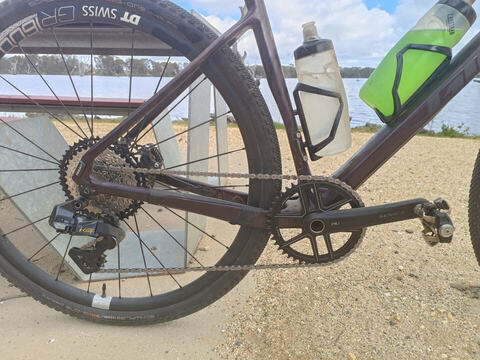

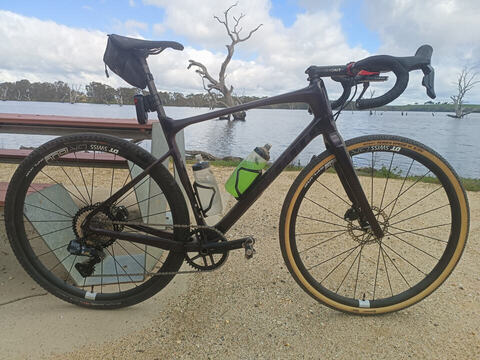

Out to Heathcote and back on the Revolt with the Ltwoo eGR today.
Early days so I’ll try not to start raving but very happy. Not a missed shift, very precise. I did a very quick visual guess adjusting the derailleur setting yesterday arvo. Brakes aren’t super strong but I may have got oil on the front disc. Didn’t spot any but I did spill some brake oil bleeding them. I have left the GRX calipers on and they may have a different sized piston to the Ltwoo ones supplied? I may do some research. I am able to stop quickly but have to squeeze pretty firmly.
The hoods are super comfortable and I prefer the oil port location on top of the hood to the Ultegra 8100 on the Reacto. There is a handy slot in the plastic body of the levers to locate the 5mm long T shaped allen key you need to use to secure them. Works great.
Only concern I have is battery life. I rushed setting the sensor detail on the Garmin today as I was running late. It offered to set a new page that included battery level but I cocked up the settings in my haste. Will have another go later. It did 3h40 or 100km today and so it should but the battery cant be very big in the rear derailleur as it is. Hopefully it proves durable. It is nice to be rid of the stupid internally routed cables.
The 10-45 cassette with 44t ring is a bit over geared for gravel but I will also use it on road with another set of wheels at times. The 2t gaps in the bottom of the cassette aren’t ideal but I can live with them and nice to be rid of the front derailleur as it was a pita to set up and keep adjusted properly. I will post again when I have some more ks on it.

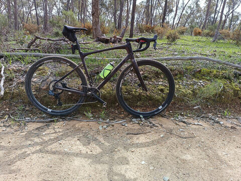

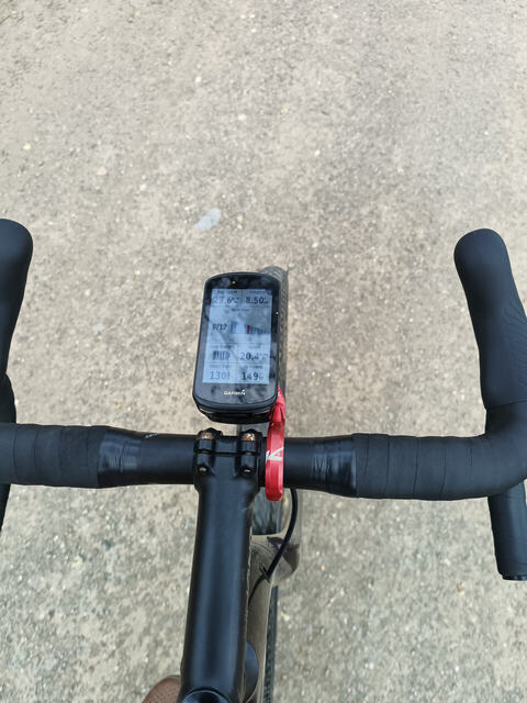

A couple more rides on the eGR. Got the battery and gear position on the Garmin now.
Not too worried about how long the battery charge will last now. The head unit was giving me warnings the shifting battery was critical low on stopping. Pretty sure that was just the eGR going to sleep when stopped.
Still shifting very well and still find the hoods more comfy than the GRX were.
Put a 29x2" Conti RaceKing I had at home on the front. Not the fastest rolling but grips well. It can stay there a while.

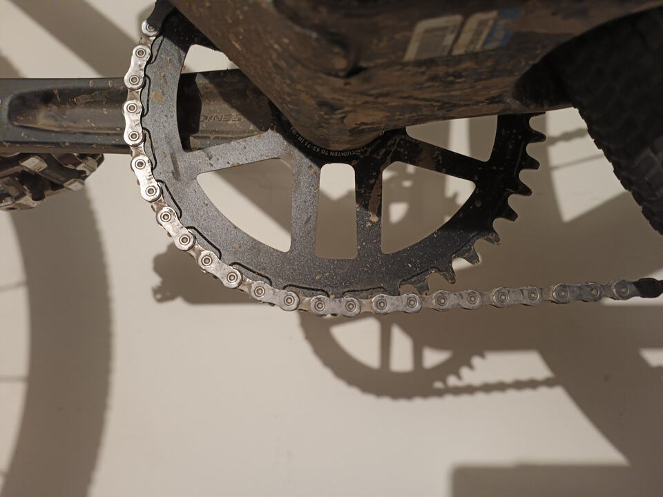

I haven’t got a chain keeper fitted but it hasn’t looked like dropping the chain. Apparently those narrow-wide rings are pretty good in that respect.

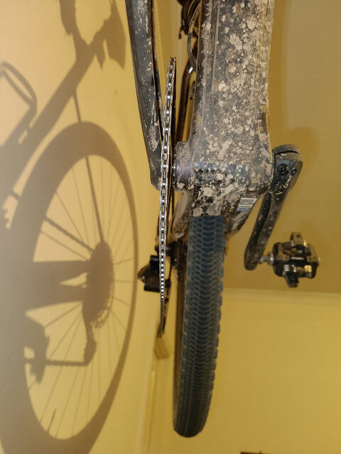

Have my Singlespeed a clean today.
It had been sitting with a fine coating of gravel residue for at least a few days.
By which time it mostly brushes off.
Then a bit of a polish with eucalyptus oil solution.
Needs a new chain, which I purchased today.
Yeah, apparently they stop the chain from moving sideways and therefore dropping off. All my bikes have them.

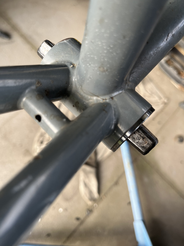

Frame is back from repairs so I was getting it ready for a bit of paint when I noticed this crack at the seat tube/bottom bracket junction. What do you think, game over for the Kona?
Well i don’t recommend riding it
Can you send a photo to the bloke who did the other repair and see what he says?
I am no expert but perhaps it can be welded over?
Yeah, done. I’ll report back when he responds
