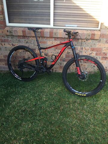

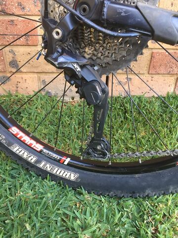

103095780_1670052269811542_7873176029655192712_o 104084589_1670052219811547_7928617158634697048_o
this is the anthem im thinking of, looks like a non stock rear wheel and xt bits, anyone notice anything off about it? total n00b.
The rear wheel was probably a replacement for a crashed or broken one and is probably better quality than the stock one.
XT stuff is fine again may have been an upgrade to replace a busted one - not unlikely that they ruined their old wheel and rear derailleur in the same accident.
One question to ask is if the shocks have ever been serviced and have the pivot bearings ever been replaced, if so how long ago for both.
If neither have happened and it’s been ridden alot budget $300-500 (can be more if any suspension parts are needed) for a suspension service and pivot bearings to be replaced.

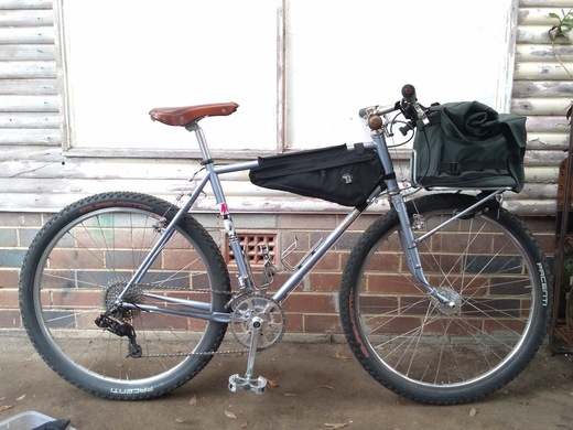

This has probably been gone over somewhere on here but I feel like I’ve arrived at MTB’s as the best option for shredding around on rather than where instagram type algorithms/social contagion theory were trying to point me at crust/blue lugged surly’s. Obviously those are touring-ish but it seemed to me a lot of people, me included, are setting those bikes up wanting mtb performance (as seen in all the clips of people jumping them off this or that, generally getting wild, 90% unloaded). Ive been riding this thing around for years (formerly erle’s), now set up with knobbies which has been a lot of fun up here but has me thinking a lot of similar bikes would be best traded for a normal mtb if ripping around in the bush is all they’re doing.
IMG_20200317_152335740
fix that for ya!
cheers blakey! not sure ill be parting with the rsogn for the full squish, might just turn it back into the slightly-sealed rack-able do all. Do you still have your rsogn?
Yeah, it’s got flat bars and vee brakes now, works really well in this setup.
As seen with Friendpoint in Japan.
looks great, I’ve been meaning to upgrade the brakes on the rawland since i got it! ah well, now i have this full sus aluminium and plastic monster worth as much as my car to worry about instead, just went for a ride and loved it, allows for really terrifying speeds, also climbed a bunch of steep sections where I’ve usually bailed out half way, maybe guilt for spending so much money was my main motivation but…
