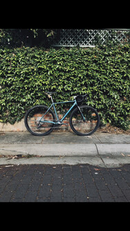

Upgraded the gravel bike, wanted Thru Axles and room for at least 700x45s.
Pick it up off an old guy, pretty much new condition. Stoked.

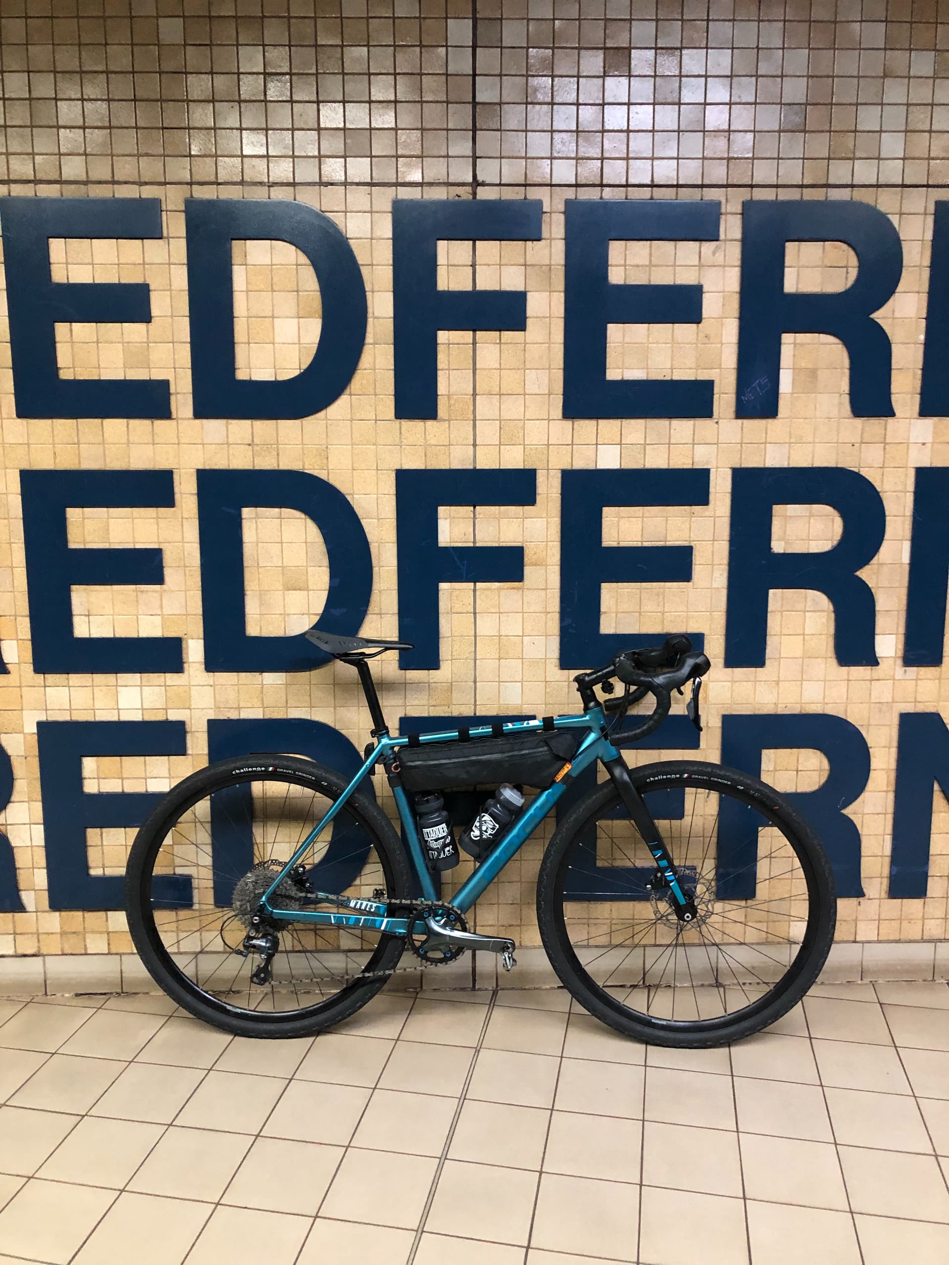

You could probably fit a 45 on the front but the 42 on the back is probably the biggest, possibly a 43 pending what style of tread pattern.
Currently running 700 x 44 WTB Raddlers front and back with plenty of space up front, and still room to go out back for at least a 47 i reckon.
45mm seems like the sweet spot for my current riding though.

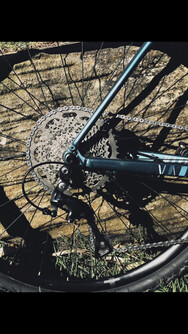

I thought I’d see how far I could push the 10-speed Tiagra. I’ve been running an 11-42t cassette with a Goat Link, and it’s been great. Now, I’m trying out an 11-46t cassette with a new Shimano chain, and the gear changes are a lot smoother compared to the KMC chain I used with the 42t. On the first shakedown ride, everything worked perfectly. All I needed to do was adjust the B-limit screw a bit more, and now it’s dialed in. Happy days—bring on more hills!
IMG_6692
IMG_6693
That’s some pretty low gearing…
On my most recent refresh on the NFE I ended up with a low gear of 28/34: 44/28t chainrings and 11/34 cassette. I haven’t got anywhere near the granny gear yet, might need to head out to Colo or something to give it a run.
It’s Low enough for me right now and the knees are happy. my mates rocking a sram eagle 11-51 cassette it’s a monster.
Colo definitely has some climbs for testing low gears that’s for sure.

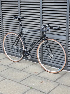

Recently picked up a paddywagon for sometimes commuting.
Did today: swapped crankset and wheels to stuff I had in the shed. Paid kids $5 to get previous owners stickers off.
Went a tooth down out back, running 50/16 now.
